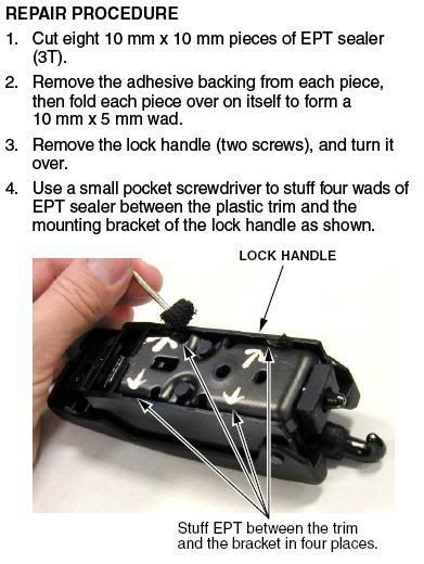

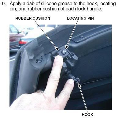

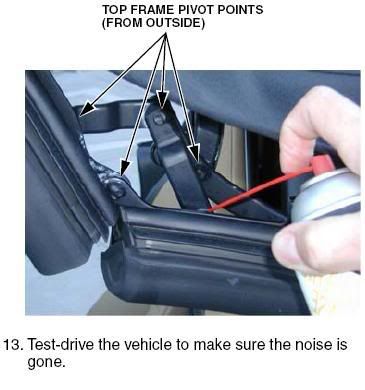

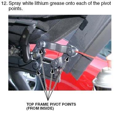

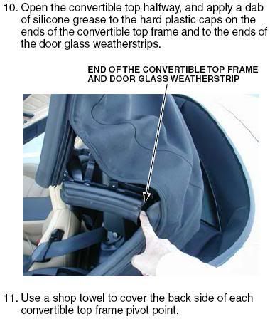

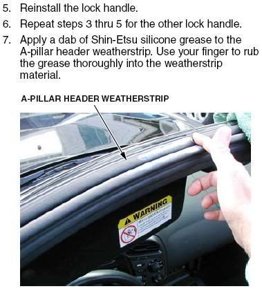

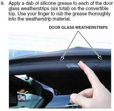

You are correct about the bulletin:
Honda Service Bulletin 03-023
SYMPTOM
The convertible top creaks, pops, or rattles while
driving over rough roads. This noise is only noticeable
with the top raised and the driver’s and passenger’s
windows closed.
PROBABLE CAUSE
This noise can be the result of any of these causes:
• Gaps between the mounting bracket and the plastic
trim of the convertible top lock handles
• Various weatherstrip pieces and plastic parts are
rubbing on the convertible top frame
• Dry pivot points on the convertible top frame
CORRECTIVE ACTION
Add EPT sealer to the lock handles, and lubricate the
indicated areas.
Out of warranty: Any repair performed after warranty
expiration may be eligible for goodwill consideration by
the District Parts and Service Manager or your Zone
Office. You must request consideration, and get a
decision, before starting work.
