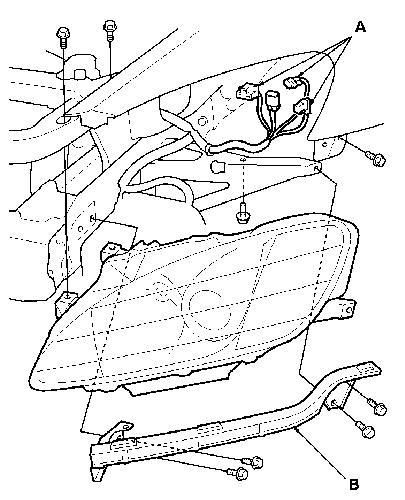

  1. Disconnect the connectors (A) from the headlights.
    Remove the four bolts, then remove the corner upper beam (B).

    Remove the four bolts, then remove the headlight assembly.
    Install the headlight in the reverse order of removal.

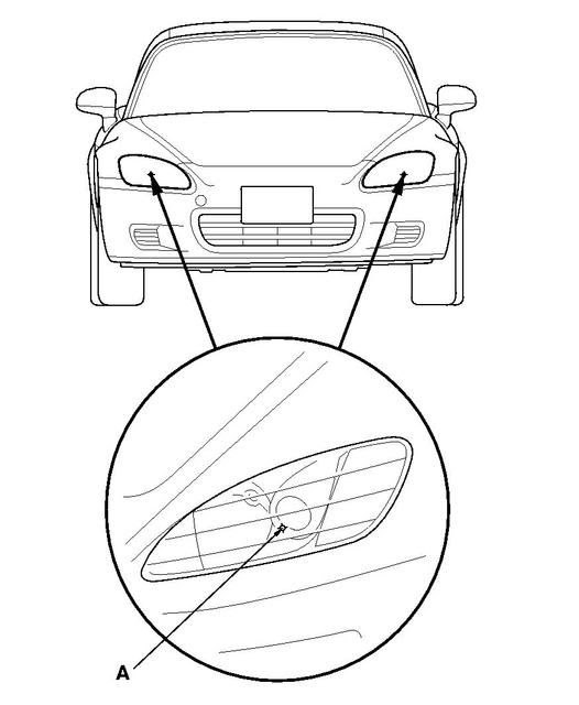

  1. Clean the outer lens so that you can see the center of the headlights (A).

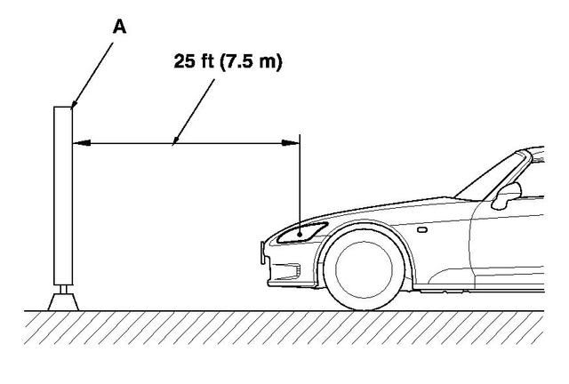

  1. Park the vehicle 25 ft (7.5 m) away from a wall or a screen (A).

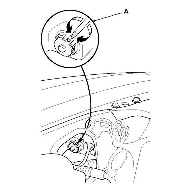

  1. If necessary, adjust the headlights to local requirements by turning the vertical adjuster (A).
