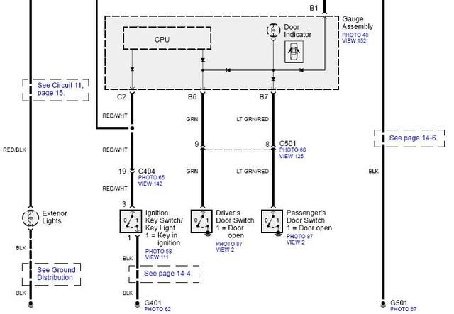

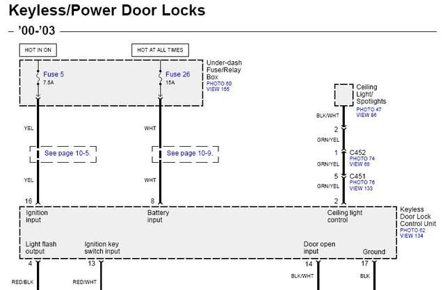

I don't know what year you have but you could take out fuse 5 but it might disable other times on that same circuit. The easiest is like they said, just put some tape or something over the switch in the door jam. But if not, here's this:
